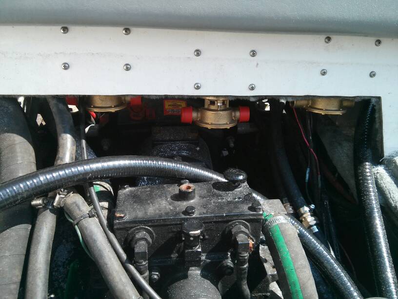

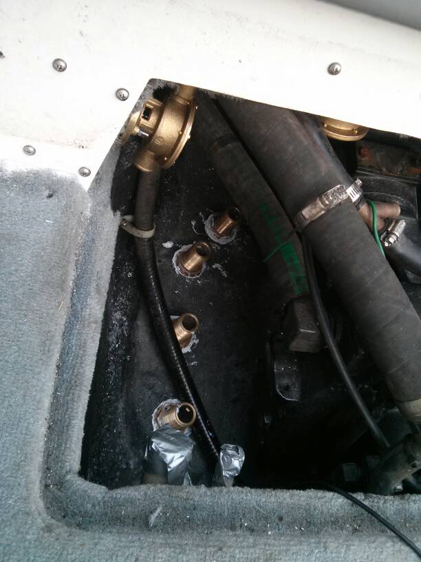

    Installed 4 reversible pumps and the thru hulls today.
    There is no space in this boat!
    Had to move the depth finder, was in the far left hole, now it's first in line..

    With the depth transducer moved forward, be prepared for some erroneous readings when the boats is at or above planning speed. The further forward it is, the greater chance there is for air to come across it. They do not "see" through are bubbles, so they tend to send incorrect readings. Same condition as when you key up with the boat on the trailer.

    Looks further forward than it is, only moved about 15 inches, figured the intakes would cause some cavitation and interfere with the depth sensor.. Guess we'll have to wait and see..
