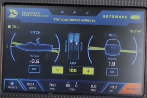

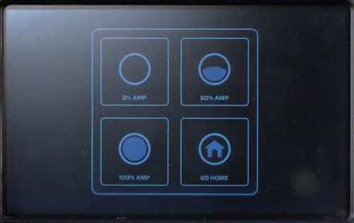

Before you begin, you should spread your passengers evenly around the boat, possibly favoring the surf side by 1 person. To turn on the AutoWake system, you will first select an amplitude preset shown on your screen. The Amplitude preset coincides with how full the ballasts need to be to achieve the wave you are trying to accomplish. For example, if you are teaching a new or smaller rider, you can reduce the size of the wave to a more manageable height, by reducing the AMP thus draining some of the ballast. You can do this by reducing the “AMP” from 100 to perhaps 50%. This function is also useful when you want to reduce the amount of water in the ballast for activities like skiing or tubing. More details of the amplitude setting will be discussed more in AutoWake Deep Dive #2.
Next, move the surf toggle switch to the side you are surfing on and then turn the AutoWake system on. An alternative to this would be to manually fill your ballast to 100%, flip your Flow Surf switch to the side you are surfing on, and then turn on AutoWake. While allowing the system to fill the ballast you should set the speed you want. Surfing most of the time should be set between 10 and 11.5 mph and it will depend on your passenger and ballast load and also the shape of wave you desire. As AutoWake is filling or adjusting the pitch and roll settings will turn an orange color. When your ballast is full, you will hear the pumps turn off, your pitch and roll settings should turn green on the screen and you are ready to go.
If the system cannot achieve the preset pitch or roll it will give you a pop-up message. It is important to note that this is not an error in the system but just guidance on how you can help the boat achieve its preset pitch and roll set points. You should follow the advice of what the system tells you in order to optimize the wave.
When you are ready to go and you accelerate up to surf speed, AutoWake may continue to make adjustments until the proper pitch and roll settings are achieved. If AutoWake cannot achieve the settings, it will give you another pop-up message to follow. If people in the boat move or you pick up or drop off people, AutoWake will make adjustments to the ballast system in order to maintain the boat’s proper position.

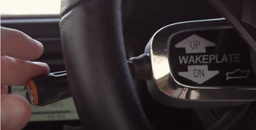

Wave shape is often personal preference so experiment with what works best for you and your boat’s setup. The SmartPlate can also change the position of the boat and in turn, affect the shape your wave. Running the plate more towards 0% or in the up position, will let the back end of the boat drop deeper into the water as it is moving and will result in a steeper wave with more push. Running the SmartPlate at a higher percentage or in the down position, will lengthen and mellow out the wave. Like speed, this is often a personal preference. We suggest starting at the factory SmartPlate setpoint and then adjusting from there for your preference and boat setup.
