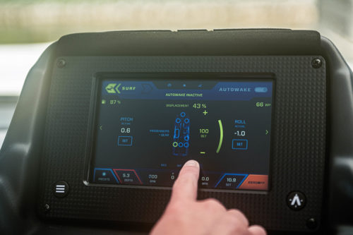

Recalibrating AutoWake:
A correctly calibrated inclinometer is the most important function of the Autowake System. If AutoWake has an incorrect calibration, it will cause the system to not function correctly, most likely resulting in a bad or small wave. The inclinometer reads information from various sensors in and around your boat. It measures the angles or pitch and roll of the boat. Calibrating the inclinometer is fairly simple.
First, your boat must be in fairly calm water, with no extra gear, no ballast filled, no lead, etc. Only the person doing the recalibrations should be in the boat.
Go into AutoWake calibration screen- go to Settings, Vessel Settings, AutoWake Settings, and then Calibrate Inclinometer.
The person in the boat needs to stand in between the driver’s seat and observer’s seat in middle of the boat, lean over, and set pitch and roll between 0 and -0.5. This is so you calibrate the system as equal to level as possible.
Next, go back to the main screen. To check that you calibrated roll correctly get the boat up to wakeboard speed and run the SmartPlate all the way up. Get the wakeboard wakes looking perfectly symmetrical on both sides (basically a good-looking wakeboard wake). Your roll should be between 0 and -0.5. If not, while still at wakeboard speed and having a good-looking wakeboard wake, go into settings and reset ROLL ONLY to zero.
